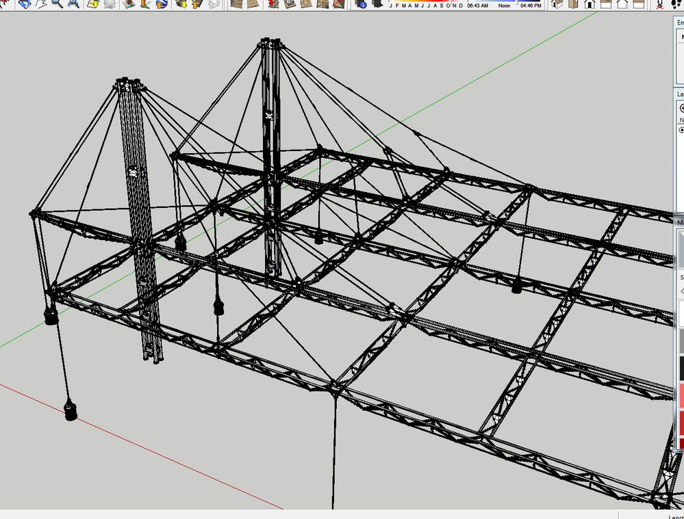

Exporting from Rhino to 3DS seems fine, but when importing into Archicad 16 using the 3D Studio In INT addon, the GDL scipting of the object is blank and nothing appears in 2d or 3d, even though the popup message says "object has been newly created in embedded library." the size of the gsm file is 1kb.
I thought maybe Rhino was exporting a format that archicad didn't like, so I imported the file into sketchup 8 first, which opened fine. I then exported another 3DS file from the sketchup file, and then imported this new file into archicad. This time information appeared in the GDL script but a lot of the geometry was missing.
Everything is on the same layer, no hidden lines or meshes.
Has anyone encountered a similar problem before?

Instead of exporting the complete model from Rhino, export from Rhino in phases and create individual objects, to verify that AC is not chocking on a Billion+ Node model.
To line them up in AC you can convert the Objects into Morphs or you could place an object (box preferred) in Rhino that is exported with all the phases (on a corner off to the side so that AC can create a hotspot for it) and use it as a registration point.
