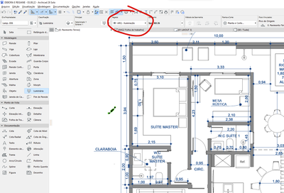

In Archicad 26 (3003 BRA Solo - Windows), it's not possible to change the light objects' layer in the toolbar. All other type of objects seems to work normally.

Though if I enter the Lamp properties, I was able to change the layer in the Properties dialog box.

In AC26 beta version was the same only through Dialog Settings changes the layer of lamps.

I just tried with AC26 Build 3010 and it works. I was able to change layers for a selected light using the Info Bar.

Hello,
Thank you all for highlighting this issue!
This is a new bug which is already entered in our database under DEF-10251.
Until the fix of this problem I suggest using the element setting dialog to change the 'Lamp' objects' layers.

Perhaps this is a Windows only problem? Because it works on Archicad 26 on my Mac.

Apparently only on Windows,
I checked on Archicad 26 INT FULL 3001 version on Windows yesterday, it does not work, only using the element setting dialog.

This issue remains in AC 26 3010, is there a solution?

I've installed the latest version, AC26 4019, and the bug remains.
