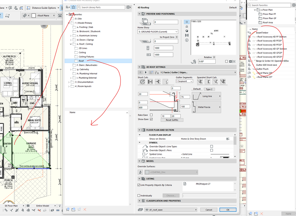

Thanks Barry, The process of applying the accessory then updating with favorites has only been born from the fact that the accessory can only be applied at default settings. I don't have the option to select the preferred favorite in the libary part list when applying in the 1st instance:

You need to set the favourite settings before you place the favourite.
Has to be saved while in the accessories settings.
Otherwise it just set as an object favourite.
I already have a long list of favorites ( palette on the right) but they don't appear in the library list on the left when I apply the accessory. The folders show up but not the library part within. And I really don't want to be creating them all again if the roof accessory isn't an isolated occurrence.
