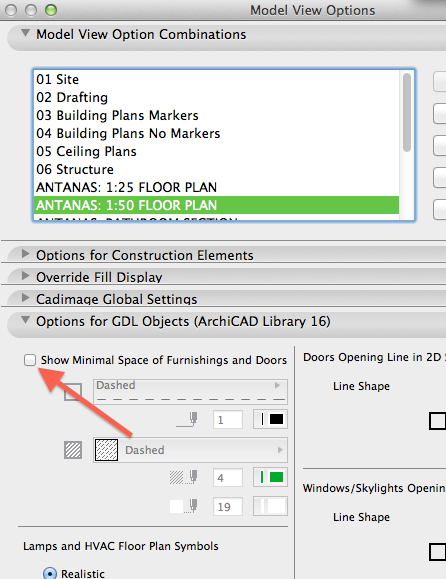

I'm moving from AC11 and I notice the AC18 Toilet ( WC 18 ) has the minimum space settings, but no Hotspots and no fill to show the minimum space area.
Where is the setting to turn on the hotspots and/or minimum space fill?

Have a look in Model View Options. You may have to turn on "Show minimal space" here for it to become active.
sirduncan02
Thank you! That checkbox, combined with the line color makes the hotspots appear, and the fill/outline of the minimum space go away.
Thank you.
