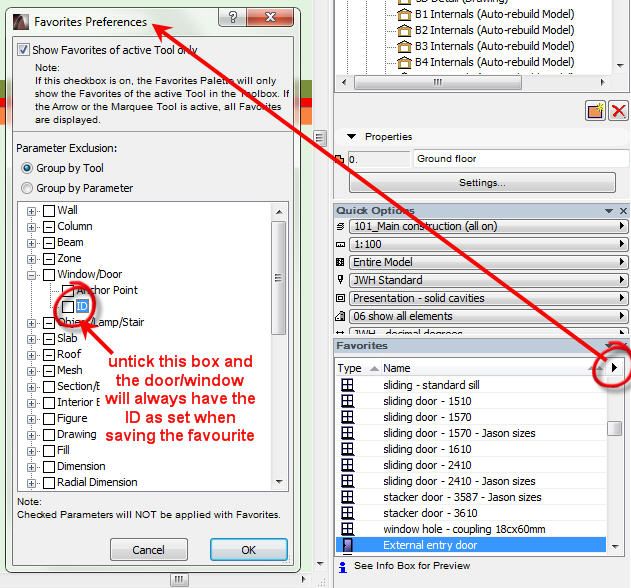

Don't forget in your Favourite Settings (the little triangle at the top of the favourites dialogue) you can un-tick the box to ensure that the ID is always set as it was when the favourite was saved.
The catch is you have to use the favourite every time you place a door otherwise the ID will increase automatically if you have that set.
It also affects all doors and windows - you can't pick and choose.
