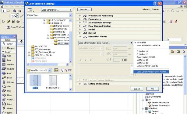

I seem to be getting the same problem - I have created my window marker and can find it in Microsoft Explorer, but when I try and load a window-door marker it doesn't appear. I have clicked placeable, but still no joy as you can see from below. I have also reloaded the library too.
Chris:
Is the marker of the Window-Door Marker subtype (see Duane's Placeable.jpg from Fri Dec 05, 2008 5:08 pm)?

I have just managed to get it to work - under the GDL parameters page you have to click on select subtypes and select the window/door marker subtype - it will then become visible..
I meant to attach this to the previous post.
Yes, that is a necessary thing, otherwise ArchiCAD will not know that it has to display it when you are viewing or searching for Door-Window Markers.
See, ArchiCAD is coded to display in the Marker panel of the Door/Window Settings Dialog only those Library Parts that have that specific Subtype.
That's how it works.
