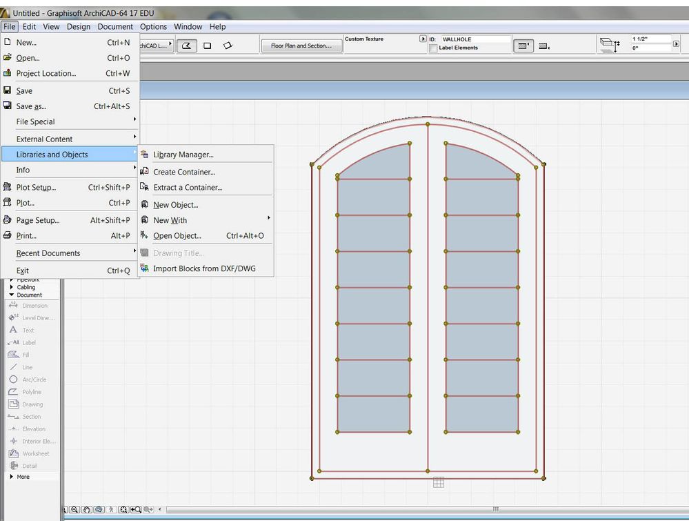

So I made this custom window out of slabs as everyone suggested, however when I go to save it under libraries and objects, there is no option to save it! Is it because I am using an 'educational version'?
If that's the case, does someone want to save it for me?

EDU version does not have any limitations so that shouldn't be it. Your menu looks different than mine so it could be that you imported it from a previous release?
Can you go "Options-> Work Environment -> Menus…" and select under 'Command Layout" -> Standard Commands AC17 and try again?
Or you can try saving the object from the 3D Window?

Thanks! Adjusting the Work Environment fixed the problem!
Ok so I still got it to save but it comes in all wrong and not at all like what I drew. Any expert want to save it for me?

Despite saving it as a window file and making it out of slabs, when placed its and object, basically looks as if I drew it out of lines, doesn't insert into walls or anything.

There are some newbie errors but the main one is that you assigned the ID "WALLHOLE" to all the slabs. The Help Center instructions indicate that after you draw the window or door with slabs and walls, then create a NEW slab with the window/door shape and assign the "WALLHOLE" ID to that one
http://helpcenter.graphisoft.com/guides/archicad-17-int-reference-guide/virtual-building/parametric-...
2.
Using the Slab or Roof tool, create another element whose contour matches the outer contour of the desired wall hole or wall niche.
Since you assigned Wallhole to all the Slabs AC was creating an object that is invisible.
Also to align the window to the middle of the wall you should align the elements in section to match what is needed. If the wall is 8" deep then the wallhole slab should be 8" also and the position of the other elements should be in the center of the wall (see other screenshot) This might be unnecessary but that is the way I am used to doing it.
