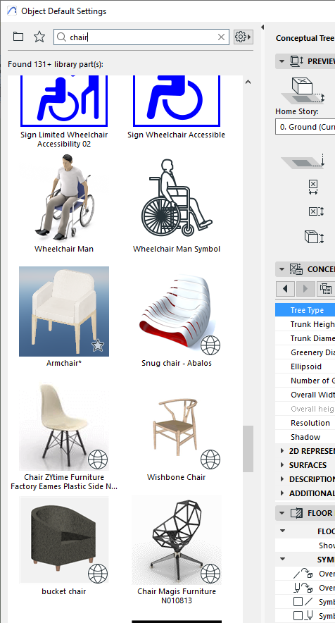

Hi everyone,

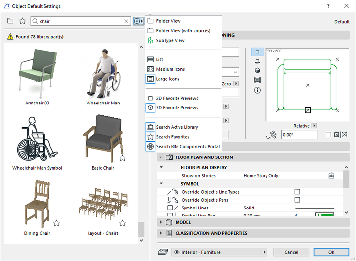

When I searched for an object in Archicad 27, it was also searching in the bim components portal and showing me the results, when I do the same search for Archicad 28, I don't get any results. Has there been a change in this feature in Archicad 28 or is there something I am missing?
Btw in both images, the search option on the bim components portal is active.

In 28 it is not a tick box option as you have shown in your image (that was probably 27)
It I now a button so make sure it has the blue box around it to say it is active.

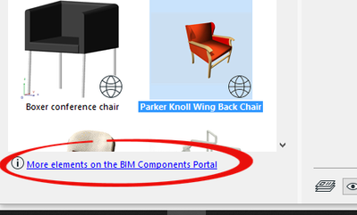

Can you access the BIMComponents website directly with the link at the bottom of the dialogue?
I just tried this and I can confirm that it does not work for me either in Ac28. I made sure that the "Search BIM Components Portal" option is enabled, yet, when I Search, the Object Settings Dialog only displays results found in the Active Library and in Favorites. I will report this to GS HQ.

Takes about 30 seconds, but it does show the BIMComponents objects.
Can you access the BIMComponents website from the link at the bottom?
No, it still does not work. Also, no link appears for me at the bottom. And I just installed Ac28.0.2 so I am on the latest Hotfix.
I am also 28.0.2
That link doesn't show for me either until I do the search and the results pop up.
