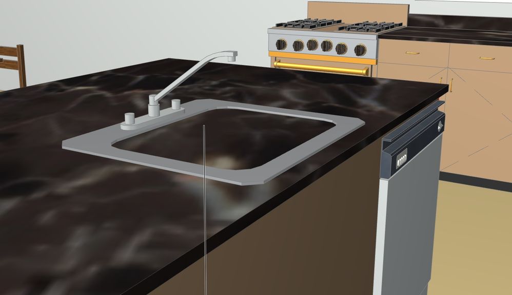

s2art wrote:Yes there is a prism bigger than the bowls (the size and shape of the required cut out) that is concealed in an "if GLOB_CONTEXT > 40 and GLOB_CONTEXT < 50 then....." statement.
In the image below the sink is from Cadimage's Cabinet Builder library, and uses SEO with upwards extrusion to penetrate the bench top. I have no idea how they have done it as I don't have a clue about GDL, but it appears that they somehow have an element slightly bigger than the sink bowl itself which can be used as the perimeter of the SEO Operator to form the cut out.
Nice.
