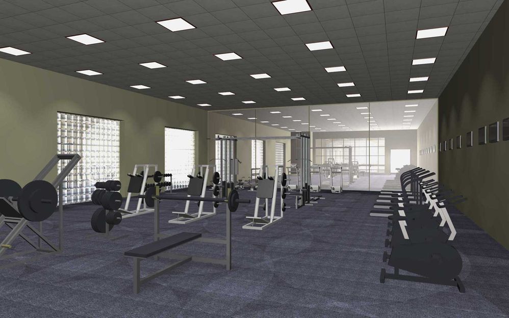

I've had fairly good success applying the ceiling tile texture to the slab material to mimic a lay-in ceiling.

With regard to your image, I have several questions on the manner in which you do lay-in ceilings. Since I'm really the guy that caused this thread to be started and since you are a good ole TEXAS boy too, I don't feel so bad imposing-
1. What is the source of the texture for 2x2 grid& tiles?
2. Is same texture used for both renderings and reflected ceiling plan?
3. What is source of light fixt., Archicad library or other, what are significant settings?
4. How do you cut holes in slab for fixt. (boolean)?
Now to the wall - What texture did you use for glass block windows?
Thanks in Advance,
It is a 3rd party texture from a library in our office. I'm not sure of the original source of the library. It's named TL_66 Ceiling Tile
No, the texture is just used in the renderings. For the ceiling plan I applied a fill to the ceiling slab to show the ceiling grid.
The light fixture is the Archicad Fluorescent Recessed 01. I'm not in the office, but I believe the settings were the default. I did have to check "use the object's materials. Also I may have increased the light intensity.
I set the light fixtures slightly below the ceiling plane and they show in the rendering this way.
The window is theW Glass Block Wall with Glass Block1 for the glass texture. I had to size the texture to the size of the blocks in the window.
