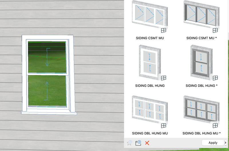

Hey guys. I have a library of favorite windows I like to use. In the preview window, they are all set into a generic wall, which is concrete. Is there any way to change the wall type of one specific window to another wall type, like brick or siding?
I want the wall type of the previewed favorites to be siding in this case, but I see no option to change it, nor have I found one in my internet searching. I know I can just change the generic building material surface, but I have multiple windows that are supposed to be set into multiple different walls.

This is what shows in the settings 3D preview. All I can think of is the wall closure setting is set to brick veneer, so maybe it is just a setting used to differentiate the wall closure settings.
I just tried changing the wall closure settings and saving it as a new favorite, but there is still a generic brick wall surrounding the window.
To clarify: Since last week, we have been changing some settings in our template, and the wall type the favorite windows are projected as being set in is no longer concrete but brick.

Yes, that is true and it helps, but that isn't my problem. I need the wall types the windows are set in to be different than what they are now.
Really, I just to know if it's even possible for specific windows to be set into specific wall types in the Favorites Palette.
In other news: All the wall types were changed to a generic wooden texture as of today. I don't know how this happened. I haven't changed any materials in the MVT or changed any surfaces or anything. It's better than CMU or brick, but it doesn't make sense why it even happened in the first place. I'm wondering if it has something to do with the fact that I selected a complex profile made of wood, but I don't think the wood texture in the complex profile was the same as the wood texture in the palette.
Screenshot attached for more info.

I have never seen this before. This is how it looks like in the German OOTB template:
GDL has the ability to generate a special symbol/geometry for the favorite viewer. However, I've never seen this utilized in any GS object before (screenshot is from the monolithic lib tho; maybe you can tell us which library you are using?).
But even then, since it comes from the script I don't see any way to influence this on your side...
