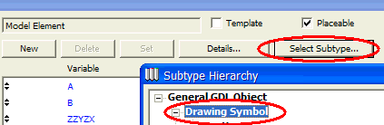

Create Subtype Template?
I'm losing it...I know I've created subtype templates before, I can see them, it looks like I even created some by accident. Can't find it here or in GDLTalk.
If anyone knows that, maybe they can also point me at the tip about using subtypes to copy parameters to other objects. Or did I dream that?

Re-purposing a screenshot ... so ignore the red circles... but notice at the top of the GDL window that there is a check box for "Template". Click that and save your object and it becomes part of the template hierarchy whenever it is loaded.
It won't let you copy parameters to other objects so much as it will add the template object's parameters to the available parameters of another object whose subtype is switched to the new template object. Whew?
Of course, be sure to select the desired template for YOUR template before saving so that it inherits as many useful parameters as necessary and is placed in the correct position in the subtype hierarchy.
HTH,
Karl
