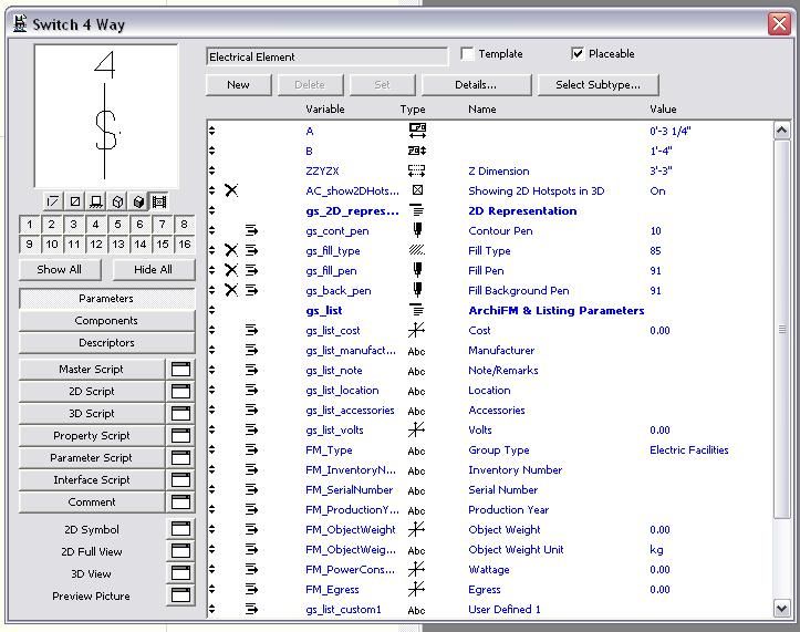

I am looking to create a electrical switch with editable Sub-text. Like the attached image of the "switch 4 way". I want the "4" to actually be an editable value. I also am looking to locate this value in a different location base on the Symbol. This location does not have to be a editable location.
What are the steps to accomplishing this?

How can I get Two Array value. See Attachment of the Ref Sid-by side.
[1] [2]
I only get [1] array when creating a new object.
[1] [2]
Click on the little ARRAY symbol to open it and then select the "1" column header and press the INSERT button.
Select the row header to insert more rows if needed also.
Frank Beister
In the settings of the array in the parameter list you can add rows and columns to get two dimensions. 2 dimensions is maximum.

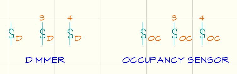

Thanks for everyones help.
Here is my simple library part that I will share with the community. (Attached to next message)
The design of this object was a result of desiring the ability to have a Switch that can be modified to address the new California Title 24 Energy standard (2005).
The object uses the element ID as the type of switch (i.e. D for Dimmer and OC for Occupancy Sensor) If ID is left blank, there is no notation as in the case of a "normal" switch.
Within the Parameter settings is where the switch number is found. The default value is blank, but a 3-way or 4-way can be specified if desired.
Hope it helps someone out there........
