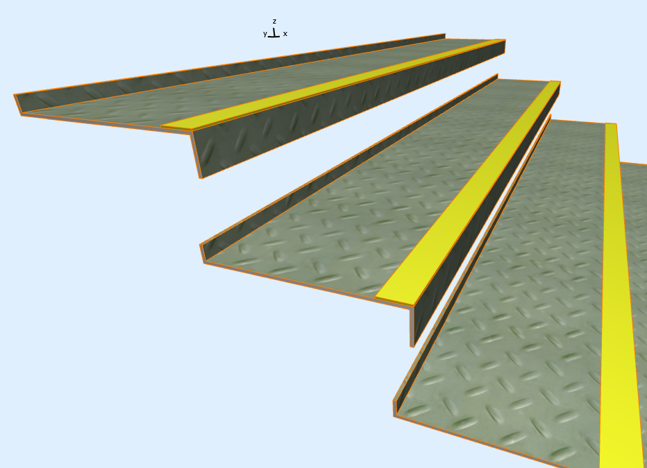

Is there a way to use a custom stair tread in Stairmaker?
It's alright if it was a single story project, but with a multi-storey building I tried to use custom profile beams, but i realised it won't apear with proper break lines & 2D storey above/below appearance settings with the Stairmaker options.

You could create the basic stair in a separate file and place it as a module in your project. Then if you edit it in one place it would update on all others.

I added this Step-form into my new librariy demo-part. The part is still under development - but at the end there will be an english version of it. But it still takes some time...
The yellow bar on the step is not implementd now but thats peanuts..
