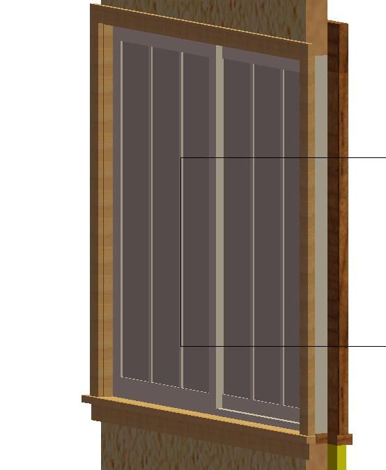

I am attempting to use a Custom Panel as the Sash Style of the W Gliding2 window in the AC9 library. The custom panels are not "lining-up" properly?
11 Replies 11
Other Minor Problem is the gap between the panels.
Here is the same window NOT using a Custom Panel for the Sash Style. Panels ar placed properly and there is no gap.

It looks like you might have saved the custom panel as a window instead of an object.
re the gap between panels:
If you created 2 panels and saved them as one custom panel, check the gap between them.
If you scripted the panels then check the math of the y or z offset.
HTH

Jay,
It looks like you have saved the custom panel with the wrong origin. I am not familiar with this particular window, but it is probably expecting either a lower left or center origin for the panel. Since the sashes are offset by half their width I assume that yours have the other setting than is expected. As Erika suggests you can control this (without editing the GDL) by saving the panel as a window (center origin) or a library part (lower left origin).
The thickness of the panel should be handled automatically but perhaps this doesn't work for this window. It should work if the sash thickness in the window settings dialog matches that of your custom sash.

Saving the "Panel" viewing it like elevation view and saving it as an object did the trick. the origin does not seem to matter AFAICT.
ALso when I was saving the "panel" as a window the origin also do not seem top matter, I tried the edge and the center of the window.
