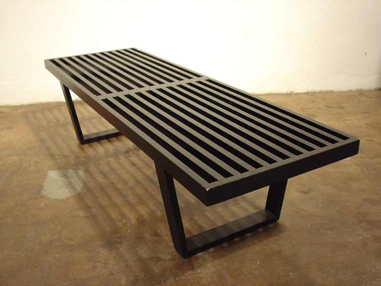

Does anybody have eames plywood lounge chair, bertoia side chair and george nelson bench I could download for a project I am doing?

nelson bench

neutra.des wrote:
nelson bench
This bench could be made with 3 parts in ArchiCAD, then grouped or saved as an object:
1. Make the seat from a slab with holes. One hole can be copied or multiplied.
2. The vertical part of the legs from columns that are sloped.
3. The horizontal part of the legs from slabs or beams.
HTH
David
