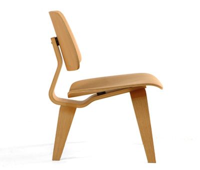

Does anybody have eames plywood lounge chair, bertoia side chair and george nelson bench I could download for a project I am doing?
10 REPLIES 10
I doubt you'll find anything that specific, but can you upload images so we can see what you're after?
nelson bench
bertoia chair
eames chair
