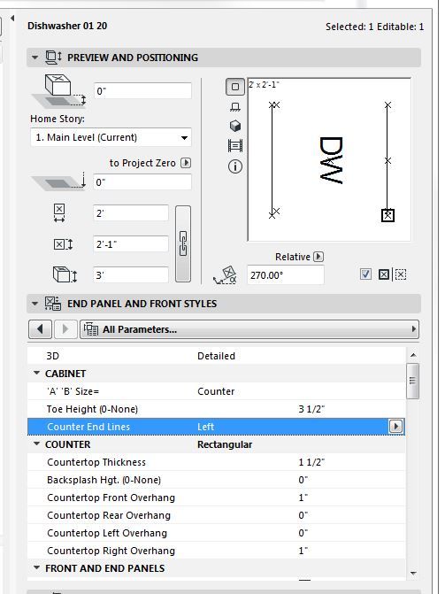

I turn on the dishwasher right end cabinet line and it does not show in plan. What am I doing wrong?
5 REPLIES 5
can you see the front line? did you try turning on the left side?
Yes I have tried everything. Left, both, right. None of them do anything.
There also should be an option for showing the edge in 3d like all the other cabinets.

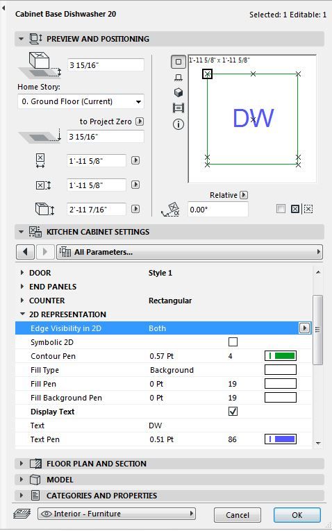

Have you tried going into the Representation tab and using Edge Visibility?
ARCHICAD 27 INT
macOS Sonoma
I see, I read you have the SOLO version, my object has the menu a little different as you can see in the image, does the solo version has localized versions or libraries like the USA library? I also see the name of the object is different. Did you try changing the setting in the Representation Tab?
I found that object in the casework section of the library. It is much better.
There one I was using is in the residential equipment section.
