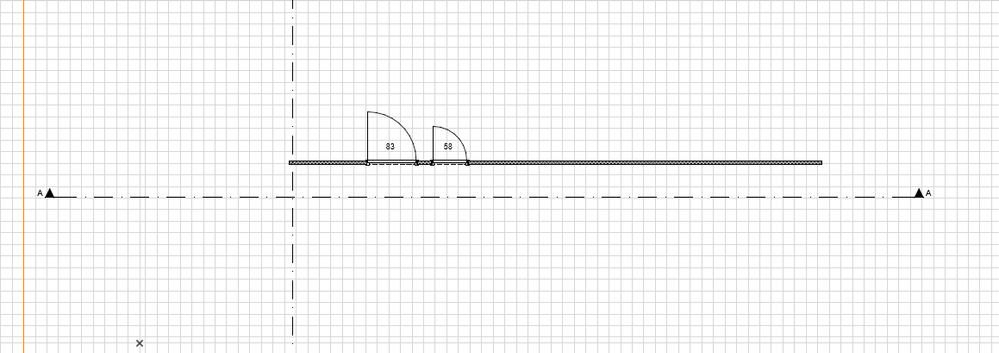

Hey,
I have a problem with the door marker. I want to have the text that is in the door to be also visible on the publisher set. As you can see its not showing.
Does anyone know a solution? Thank you

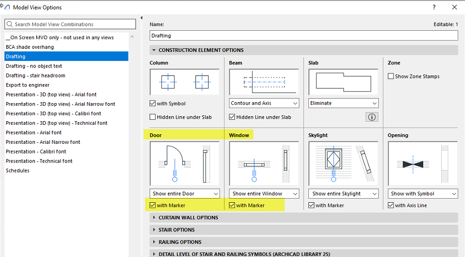

Right mouse click on the view in the View Map of the Navigator and choose 'view settings' or press the 'settings' button.
It will tell you what MVO combination you are using for that view.
Then check the MVO settings for that MVO combination and make sure that the door and window markers are on.

I would be guessing that the view settings for the view you have placed on your layout are incorrect.
In particular the model View Option combination you have set for it.
Seems you might have turned the door and window markers off?
