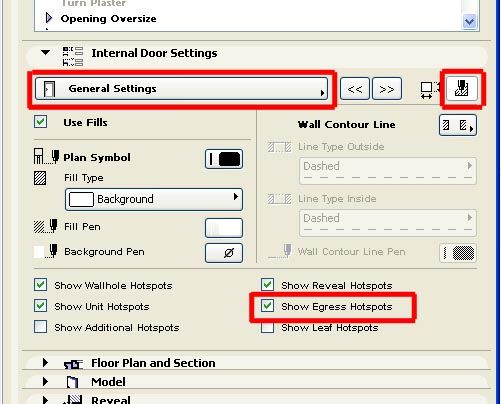

I'm also trying to see to what dimensions everything comes out as on the drawing, seeing as the number of dimension options is so large I can't see everything at once in the settings box, and it doesn't seem possible to dimension to points on a door like the frame? Is this standard Archicad practice not to be able to select points or snap to them on objects? I've had to provide critical dimensions on projects from walls to the door face before for disabled regs so its important to be able to do this.

Regarding your egress question, you can turn on extra egress hotspots to snap your dimensions to. See the image below for guidance.
Hope that helps.

Thanks for the tip about the hotspots, too many hidden areas to look at to find the parameters I want to set. I guess if I persist with it long enough and ask enough questions I'll have the answers needed to use the software to its full potential....
