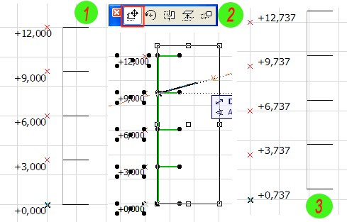

Elevation Marker – Problem!
txt=str ("% +m",y~)
pen 1
text2 0,0,txt
How to fix values «txt» that at moving they not change?

Create two variables such as "Text":
dimText1
dimText2
Write in the Master a script:
HOTSPOT2 0, 0
DEFINE STYLE "dimText1"   Arial, 3, 8, 0
DEFINE STYLE "dimText2"   Arial, 3, 2, 0
Identify = ""
Identify = STR("%m", SYMB_POS_Y)
IF glob_context < 20 AND glob_context <> 5 THEN
	PARAMETERS dimText2 = Identify
ENDIF
dimText1 = STR("%m", SYMB_POS_Y)
STYLE "dimText1"
	TEXT2 0, 0, dimText1
STYLE "dimText2"
	TEXT2 0, 0, dimText2
In АС10 this script works. It works as follows.
dimText1 always shows current SYMB_POS_Y.
dimText2 will show SYMB_POS_Y, only when the library part will be placed on the plan or a section.
If this script will is included in a library part which can to be stretched, after extension dimText2 again will show SYMB_POS_Y.

My way the following. I apply the same method as well as with texts of the sizes.
When we want, that the text of the size did not change, we switch in position "Custom Text" in Dimension Text Setting. Then we change the size of object, but the text in size remains without changes.
It is habitual for user ArchiCAD. In a library part it is possible to apply this method also.
Part of a script from my library part "Level Dimension".
Variables such as "Text":
txtOption
customTextDimY
VALUES "txtOption" "Measured value", "Custom Text"
DEFINE STYLE "dimText"  nameFont, sizeFont, anchor, typeFont
TextDimY = STR("%m", SYMB_POS_Y)
IF GLOB_CONTEXT <> 5 AND txtOption = "Measured value" THEN
	PARAMETERS customTextDimY = TextDimY
ENDIF
IF txtOption = "Measured value" THEN
	dimText = TextDimY
	LOCK "customTextDimY"
ELSE
	dimText = customTextDimY
ENDIF
STYLE "dimText"
   TEXT2 0, 0, dimText
