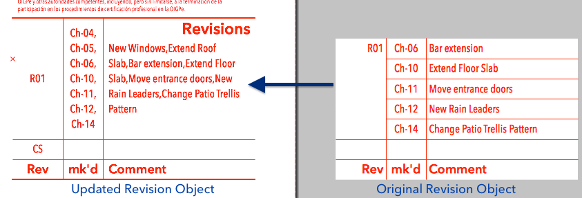

Can't seem to get the "New and Improved" Revision to match the Original. It is grouping all the changes and I need them to be one to each line.
What am I missing?

Found it, the US version does not have the detailed option.
