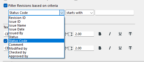

Have not tested this, but can you manually set the revision to a number / letter that has already been used? If you can, depending on how you are tracking them, you might be able to filter what is displayed based on a criteria.
That is a setting in the Revision History Detailed object that I use. If you can do something similar, it might be easier? It does mean retaining a whole lot of revision information which may or may not be a good thing.

Yeah, I guess I could change to letters instead of numbers and I could also duplicate the layouts and delete the issued ones. But that still keeps the revision history. Doesn't that men the file heavier? My files arre pretty big already 😞

It does not allow you to duplicate revisions.
