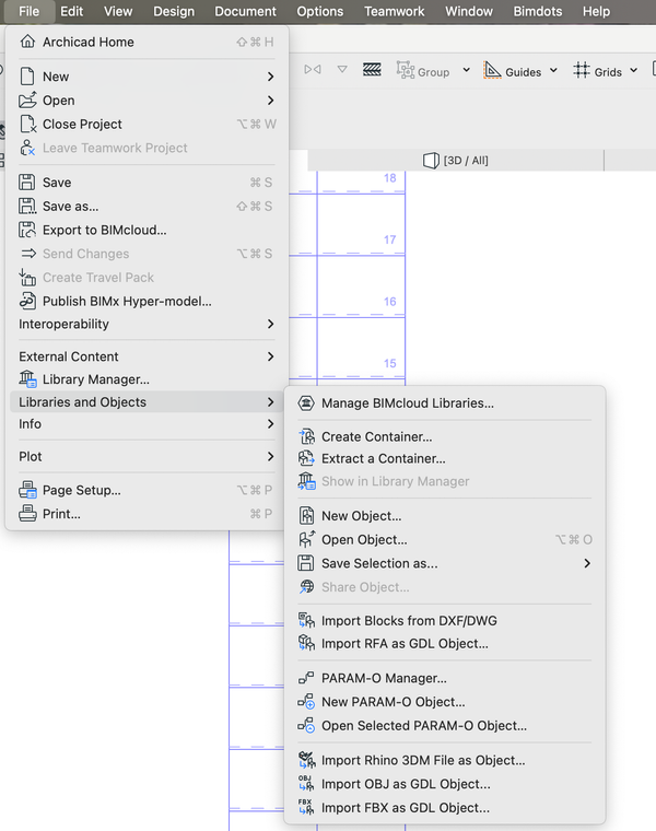

It should be there already if you are using a default Work Environment.
It won't be in the menus if you are using an old WE.

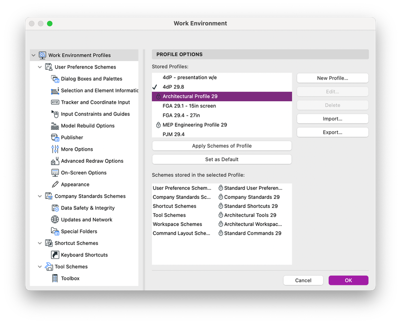

@Barry Kelly this is with the AC 29 default "architectural profile 29" w/e applied. Not using my custom w/e, and still do not see "extract library package" as shown in your drop down.
Either you have a different OOTB w/e, or you have a custom w/e that you added this command to.
Alos, the "extract container" option you have highlighted is limited to .lcf; the "extract library package" option should be the one to use; but I do not have that in my work environment, or the out of the box 29 w/e's.

Sorry I highlighted the wrong command, it should have been the one below.
Fortunately it is possible to add these commands to your own custom menus and toolbars.
