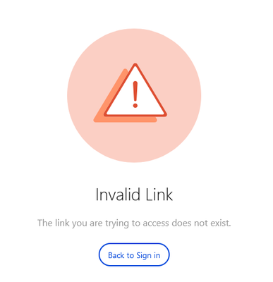

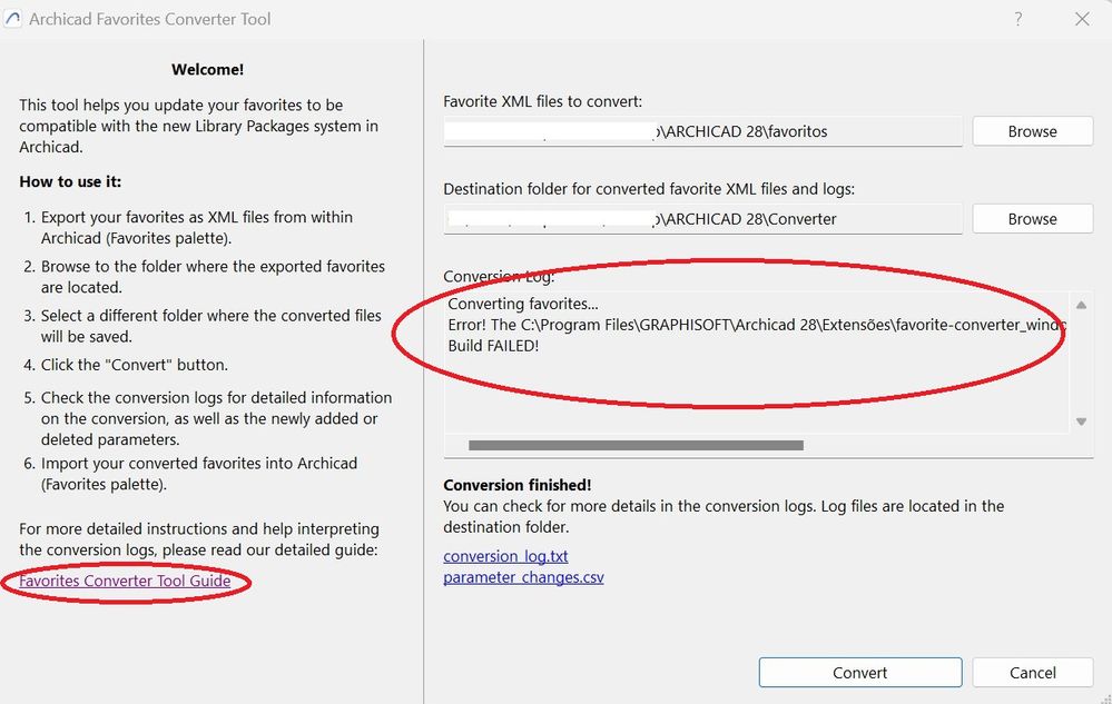

I'm having problems with the tool to convert favorites, is there any tutorial?
Since the link in question is not directed!!!!

Hi @Patrick_lgs ,
The conversion works the same way in all language versions. Could you please provide more details about your exact issue?

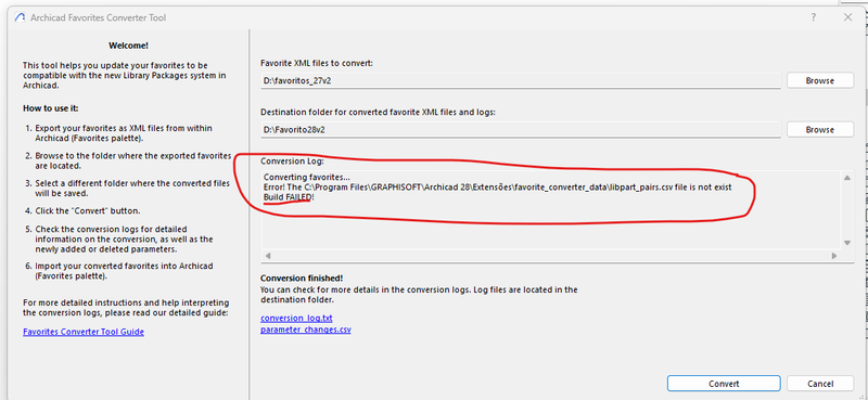

well,
I followed the steps on the pdf you provided
After the failure I downloaded the INT version of AC and it worked perfectly. But I can use the favorites converted because then I have a mix of ING and POR language.

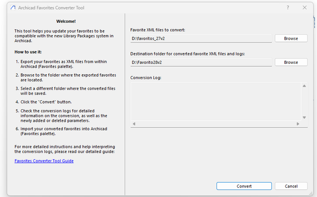

@Magdolna Marosvari wrote:
The screenshot @JLopes showed is already about the user friendly version, that can be downloaded from here:
https://graphisoft.com/resources-and-support/downloads?section=favorite-converter
I'll update the link, also the FAQ, and the tutorial video can be expected around 17th October

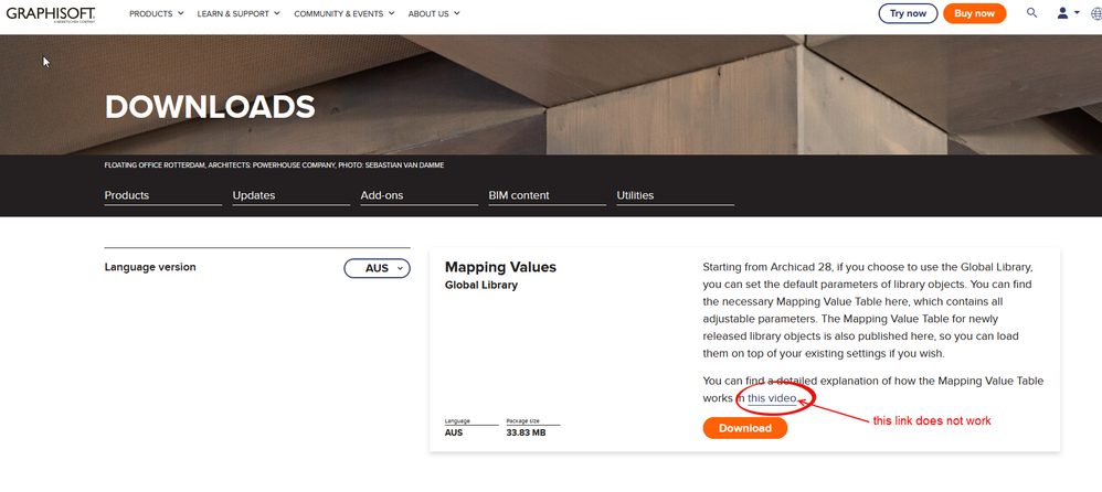

@Magdolna Marosvari
Does this apply to the Mapping Value Table as well with regards to the video?
https://graphisoft.com/resources-and-support/downloads?section=mapping-value-table&localization=AUS
There is a link but currently it does not work.
Hi @Barry Kelly ,
Thank you for letting us know about the warning, it'll be fixed soon.
Meanwhile you can find the Mapping Value explanation video attached.

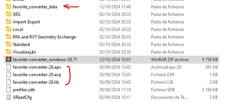

Hi @Patrick_lgs ,
Thank you for the further info. To have a clean start, may I ask you to delete the files and folders you show, then extract the ZIP file again to a different location, and from there manually add the add-on in to the add-on manager? We could reproduce this error by deleting the libpart_pairs.csv from the favorite_converter_data folder, so probably your file arrangement got mixed up during multiple tries.
And indeed the result of the converter is independent of the language version of Archicad, so you can use the ones generated by INT. Because it doesn't use data coming from Archicad, only data from the folders and files next to the add-on.
