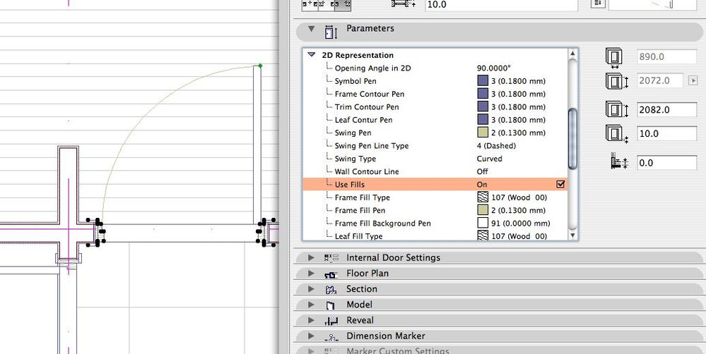

Hello -
I am attaching a picture of where I am looking for the settings you mentioned. I cannot seem to find the fill areas. Please let me know if I am looking in the wrong place.
Many Thanks - Chris
__archiben
looks like i get a different set of doors in the INT version . . .
are there any library updates available to you? (Help>Check For Latest Library...)
~/archiben

Hello Chris and Ben,
I have what I believe is the latest AC 9 library (9.0/128.pla)
and AC application (build 2018), both US version.
There is no fill option in the 2D symbol settings.
The settings appear to be identical to the AC 8.1 (US) library part.
Chris, you seem to imply that there used to be a libray of doors that
did have a fill for the door panel. I have never seen such a library
and therfor use a library of doors that I made that have fills for
the panel and the jamb and trim.
This is interesting because I thought that, aside from certain localization
differences, the only difference between the US version library
and the Int version library was the file structure.
But apparently, this is not the case.
We may have to download a copy of the Int version library and swap out
library parts to get the latest functionality.
Peter Devlin
