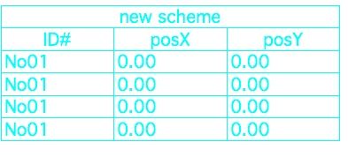

Hope someone can help me, I have done a good search but am having trouble finding a solution to my problem.. i am looking for a very simple object that displays the x and y coordinates of a point on my plan .. my aim to to export the list as a csv file then import it into a data base

Hello,
i have tried again and it seems to be work in AC15.
If you already have the object that contains the parameters eg: posX, posY
1. Document /Schedules and Lists / Schedules / Scheme Settings…
2. select the Object Inventory / Fields
3. select the object/Lamp
4. select the Additional Parameters…
5. select the Object that contains the posX, posY parameters
6. select
7. and add the posX, posY parameters
8. OK.
9. it will appear the selected parameters
10. and go again to Document /Schedules and Lists / Schedules / Object Inventory
11. Save as xls.
but i’m sorry if I may not understand exactly the question.

following your advice, I have changed the script and created a schedule.
After trial and error i found out where i was going wrong,
i had to define posX and posY AFTER the hotspots of the object were created.. i used another parameter do enter the text for the x and y (i didn't want another source of error)
I can finally see my x and y positions in a schedule (see attached screen grab).. but for some reason not ALL the objects are showing in the schedule (some still report as x=0, y=0).. so close!
I'm sorry if i am making really simple mistakes.. (i will sort the ID labelling later - that's not too hard)
I can send the obj in another post

It has to be write to the end of you master script:
PARAMETERS posX=xx, posY=yy
If you have already placed object you have to open the object's settings dialog and push OK.

I just wrote the end of the masterscript as you advised.. and i placed objects, then i also opened them and clicked ok.. attached is my schedule (still zeros!).. I'm on Archicad 12.. I'm going to try another machine in our office that's Arch15
it looks as thought the Schedule is working much better in ACAD 13,14 and 15, but i am having trouble importing the library part.. i will recreate it in 14 or 15, that might solve the problem,

I had modified the same object to be able to schedule coordinates. It has been working fine for me in schedules, without the need to open the settings dialog so the script updates values.
All credit goes to Roberto Corona for the base code. I just added some parameters and modified it a little to fit my purpose.
I'm sure it will help you. I just moved the code to the master script so coordinates get passed to the parameters -this wouldn't happen if it stayed in the 2d script, or you would get zero-
On a side note, I don't think PARAMETERS code works in the Master Script of the library part, only in the parameter script; this is why you get zeros even when using that code.

I have brought the obj into ACAS14 now with much better results... soon it will all be solved ! but i will also look at your code... and i will load the final result.. i'm really glad that the community support is excellent..
