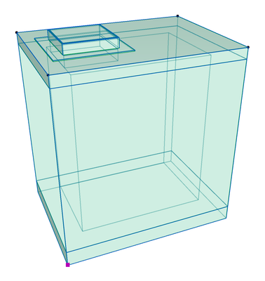

Still struggling with the hotspots.
I want the object origin at 0,0,0, but to stretch it in the z direction.
The script below works fine (when I stretch vertically, the base point doesn't move) but the vertical stretch hotspot is the component height above the origin, so it's not usable.
hotspot 0, 0, 0, hsID3=hsID3+1, ZZYZX, 4+128 !base
hotspot 0, 0, ZZYZX, hsID3=hsID3+1, ZZYZX, 2 !moving - stretch hotspot for depth
hotspot 0, 0, -1, hsID3=hsID3+1, ZZYZX, 3 !reference
The script below inverts the ZZYZX axis so the hotspot is at -ZZYZX like this:
This is the script:
hotspot 0, 0, -ZZYZX, hsID3=hsID3+1, ZZYZX, 2 !moving - stretch hotspot for depth
hotspot 0, 0, -1, hsID3=hsID3+1, ZZYZX, 3 !reference​
I can stretch the object in the z axis, but when I do, it moves in the z axis based on the direction of stretching.
How do I 'lock' the z position when dragging the hotspot??
