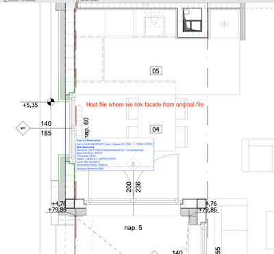

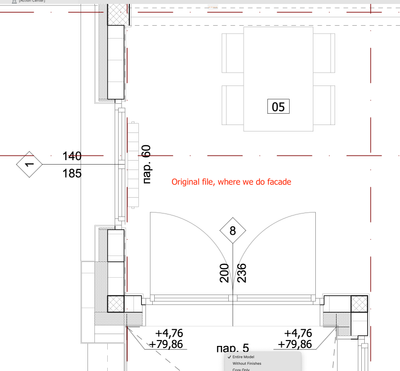

Upon working with hotlink modules we encounter the unusual behavior. The window reveal that has been set in the module file in host files behaves strangely. It overrides the reveal and turn in skin settings. Is this possible bug, or is there some setting that could prevent this behaviour? 

Just to clarify, these are standard AC parts?
ArchiMind
Yes

Marc H
Looks like an auto skin wrap is running long and covering over the custom ‘thin’ facade return.
