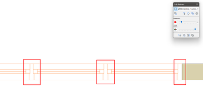

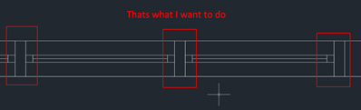

I want the frame of my window to be a simple rectangle as I have marked in the attached image, but I couldn't do it from the window settings. Does anyone have a solution?

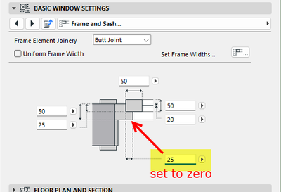

Have a look in the window settings for the frame size.
You may be able to adjust the width of the inside and outside portion of the frame so there is no lip.
I don't know what window you are using, but it might be something like this.

Thanks for your answer Barry.
But I tried this. I can't set it to zero. It has to be higher than zero.

‎2024-03-06 04:00 AM
You have selected the wrong setting, that is the Sash Frame Width, not the Rebate Width as pointed out by Barry. Your options are mirrored to those found in AUS...
You can input 0.01 if you want to fudge it.
