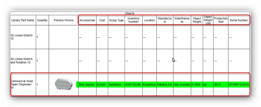

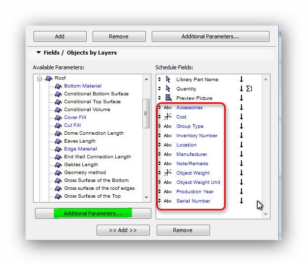

Adding "Additional Parameters":
undefined
These "Additional Parameters" in the Schedule:
undefined

Go to your Schedule, pick the button "Scheme Settings"on top right, then pick the button "Additional Parameters" (in the new opened dialog window search your Object and then select parameters to add to the Schedule). See my pictures 2 and 3!
