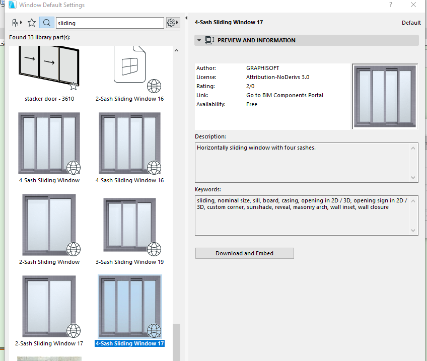

If you search in the window settings for 'sliding' then you will find 4 sash sliding windows there.
But as far as I know they have an option for a high-light, but not a low-light panel.
This image is from version 22 (all I have open at the moment) but is the same in newer versions.
As mentioned, you can 'gang' windows, use curtain wall or look for a 3rd party object.

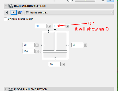

Double Window with 0.01 rebate and 0.1 center frame width. It will not allow you to actually zero any of the values, so you are stuck with a thin sliver which will show up on the inside and if you want to open the window...
Ling.
If you have the double window in your basic windows folder ...
Extra images to show what Ling is saying.
That is painful to figure out, and even then still not perfect.
I am so glad I don't use those windows and have my own!
Hi Barry, I have done this but it doesn't allow the middle frame to be 0.1 it says the minimum to be 35mm, which is still visible so I still need to cover the elevations with 2D and it shows in 3D.

You need to reduce the Rebate first as the frame width cannot be less than it. Though as you have noticed, the plan is also a bit squiff... Seems that the 2D once you go below a set value (sash width plus EPS maybe?), it defaults to the right frame width anchored to the right.

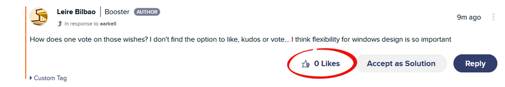

How does one vote on those wishes? I don't find the option to like, kudos or vote... I think flexibility for windows design is so important
You can like any post (except your own) by clicking on the thumb up icon.
But ideally if you want the wish to be considered, then a wish should be created in the 'Wishes' forum.
