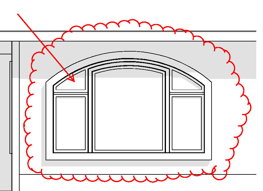

I need to make some windows like this that Gang, show correctly in Plan view and be windows I can give an ID and schedule.
We have a 1/2 Arc Top Opening but not a 1/2 Arc Top window. ?
Can you make windows like the 1/2 Arc Top with Cadimage Tool ?

Yes. That's how I made what I have. And it works for temporary elevations , but I want them to be real windows for the sake of matching how the manufacture will make them - and more importantly for my own window schedules. This is why I would like them to be fully functional windows.
The manufacture wants to make this assembly of three windows with 2 window types. It's the ones on the sides that I don't have as a library part for that will gang on the side with the center window. Notice that he does not have the radius matching the center window. yet.
Steve Jepson
I am trying to avoid the workarounds to get what I need from the windows in all of the places where they show up. Floor Plans, Interior and Exterior Elevations ( with correct shadows) , 3D views, and Schedules with annotated drawings. And I want them to be geocentrically correct and matching the manufactures windows as nearly as possible.
The workaround I am using which I am not entirely happy with is to use the openings that match the window shapes - we do have those in ArchiCAD - and place the modeled pseudo windows in the hole/holes. But there are still some places where this workaround is not entirely working. That is why I would like to use real windows that will gang together on the side.
The missing window - the one we don't have in the ArchiCAD library is the Half Arch Top with Casement below. Does anyone know of a Window like that? Perhaps in an older library or something ?
I will be able to devise some workaround but I would much rather have a Half Arch Top Casement below window if there is one.
I believe so but don't have a current copy to check; my last version was for AC 16 or so. You have to pay for compatibility with each new release of AC.
