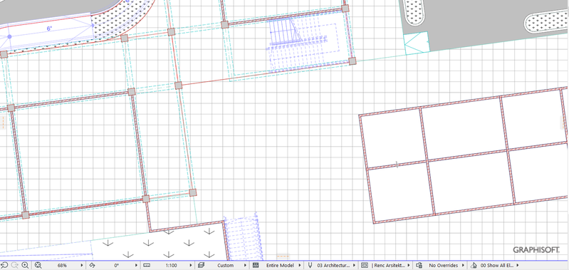

My site is a little slanted so I adjusted it, because it's quite difficult to make anything slanted so I changed the graphic orientation to straight, so I wanted the fills on the slab to remain straight when I changed the orientation. Can it?
pic above is 352 degrees
pic above is 0 degrees

Hi @mrsneuna,
You can set slab fill to follow the graphical rotation by adjusting the cover fill orientation to be linked to Fill origin.
** Additional tip regarding (Construction Grid),
If you like the grid to fit your graphical orientation, you can set it as attached below:

Can the fills be straightened automatically? I have made a lot of fills

I'm sorry, I think it can't be solved for all fills by one click as every fill has its own rotation.
However, you can create a wish for that, it may be applied someday.
