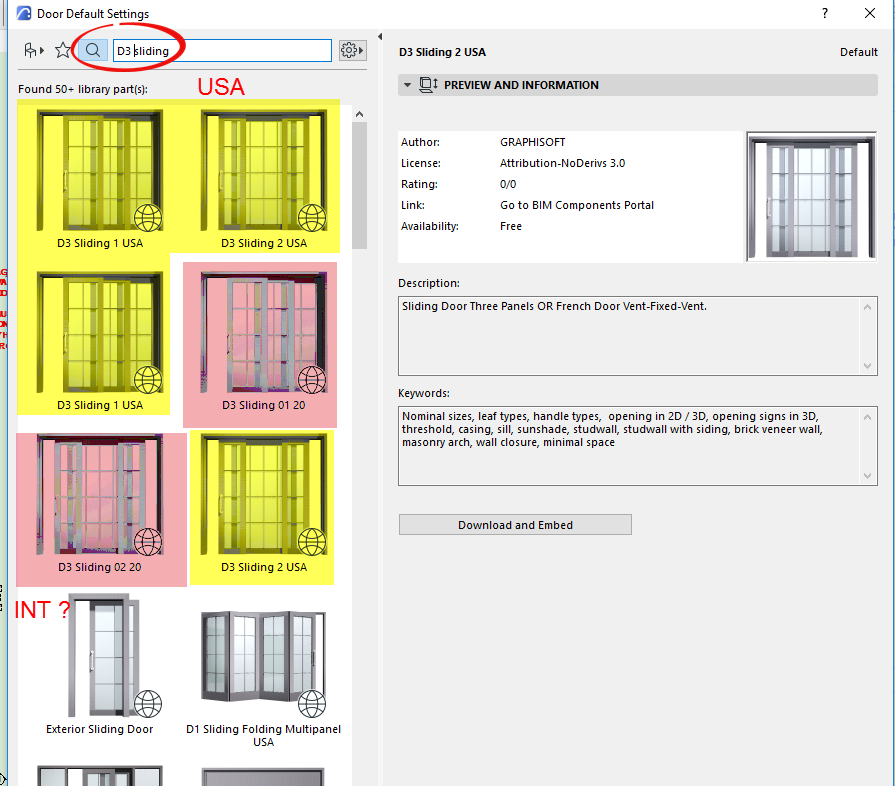

Also try searching in the door settings for "D3 Sliding"
I see there are a few doors in there that say they are 'by-pass' which to me means all sliding.
Some for USA library and the others I assume for INT (others).
