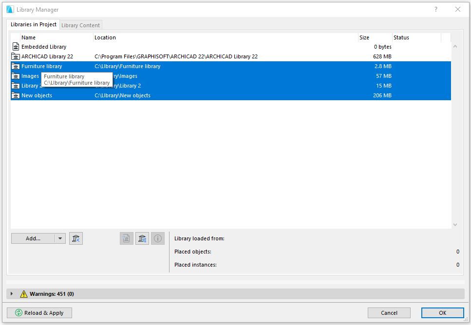

Step 0: Check Folders
Before creating the LCF make sure that all folders you wish to include in the LCF are linked and loaded into ARCHICAD so you can include only currently loaded folders in the LCF.
We will create an LCF and include the last 4, currently selected folders in it.

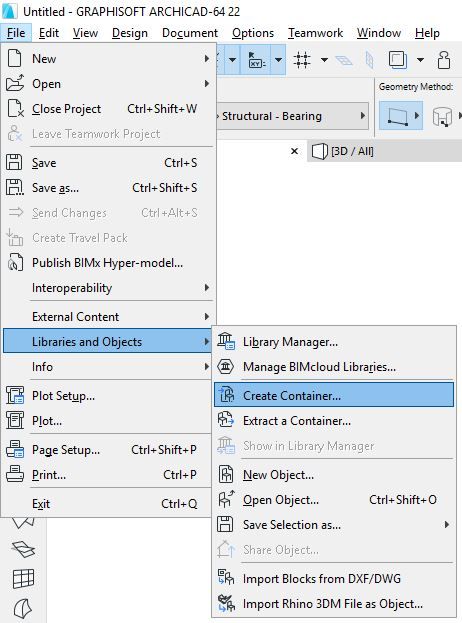

Step 1: Go to "Create a Container" Dialog
Use the File\Libraries and Objects\Create Container menu command to create a container.

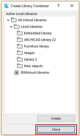

Step 2: Select Folders
In the appearing dialog, select the folders you wish to include in the LCF and click the Create button.
Info_18x18.png NOTE: You can use the familiar CTRL-click and SHIFT-click methods to select more than one library.

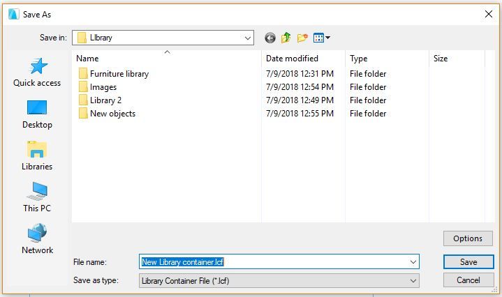

Step 3: Specify Name
In the file selection Dialog, specify the name of the LCF to be created.

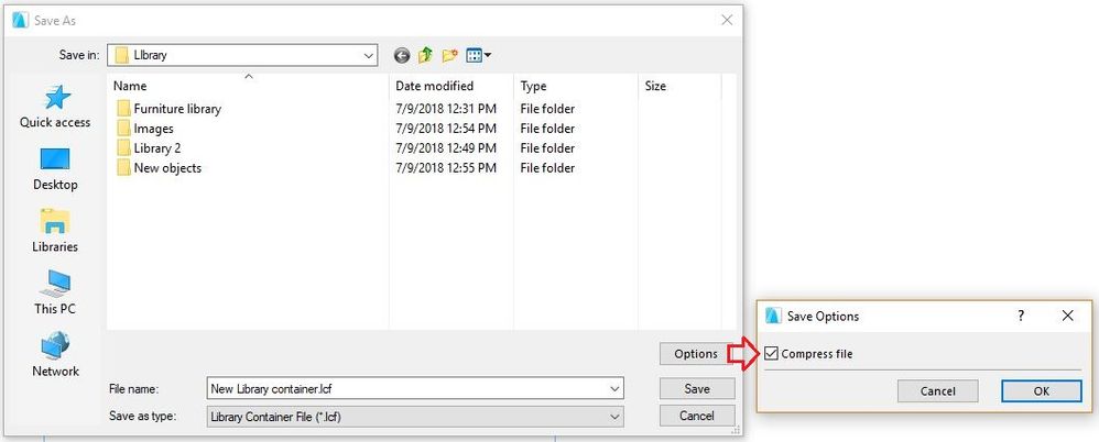

Step 4: Compress File
Click the Options button, check the Compress file checkbox in the appearing dialog and click OK.
Then click the Save button to create the Library Container File.

Step 5: Close Dialog
Click the Close button to leave the Create Library Container Dialog.

Step 6: Remove Library Folders
Go back to the Library Manager and remove the libraries added earlier.

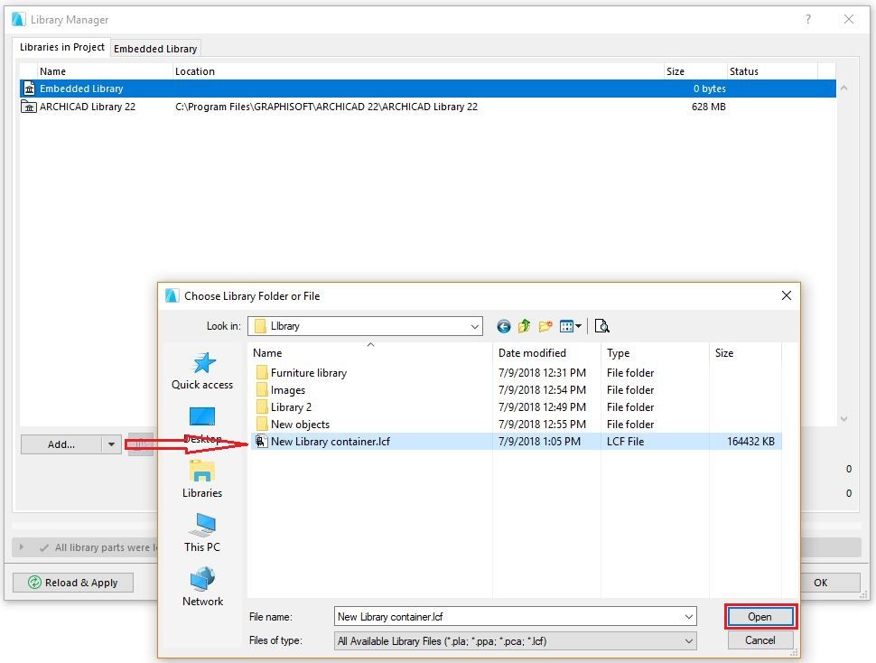

Step 7: Load LCF
Add the created LCF to the Local Libraries and click OK to reload libraries.
