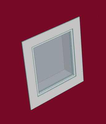

I'm sure this is a simple thing. I've spent some time tailoring a window to my liking, and now I want to have multiple instances of this window on my wall. But I want to make sure that if I change the attributes of the window in the future, all instances of the window will also change. How do I do this?
