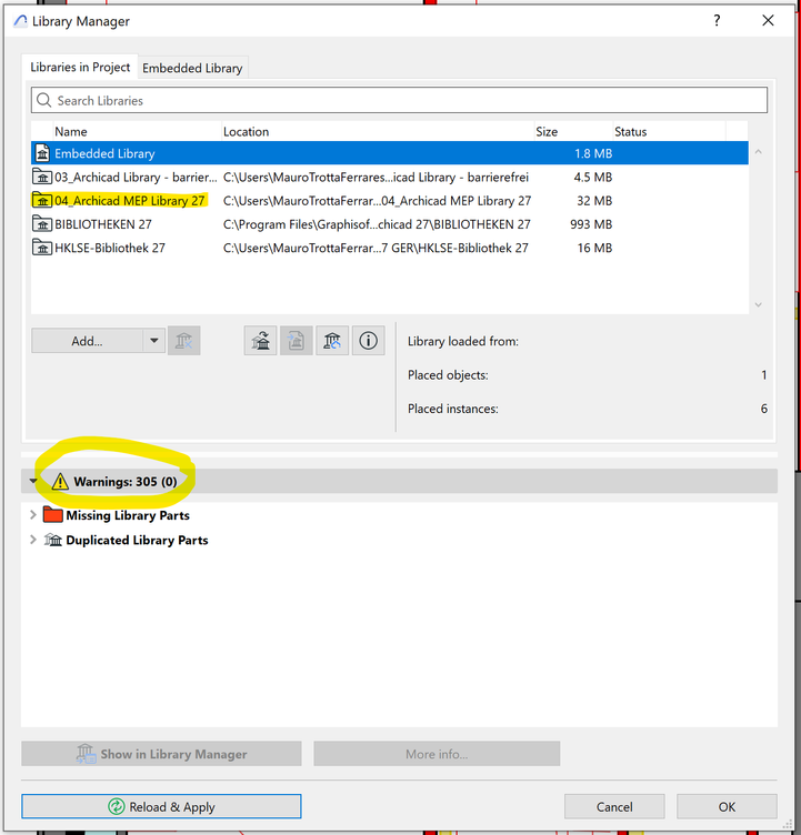

I copied an object of one file and pasted into another, and when I tried to change some of the object settings, I get this warning message about a script in the object having a negative value. I have no idea how to fix this since I am not familiar with object´s script. Can someone help me out?

That is a MEP object and there is more than likely other associated macros that need to be copied with that object.
You can't copy & paste just the one object, you need to load the entire MEP library.

Thanks for the feedback. I just realized that the file where I copied the object also has the same warning message. I tried anyway to bring the MEP library available in my Archicad (Archicad MEP Library 27), but the warning message continued, and I got some other warnings in the Library Manager as well. How can I identify exactly what Library is missing?

maurotrotta:
Click the arrow next to the Missing Library Parts folder (and you might as well do the same to the Duplicated Library Parts folder) to see a list of the missing parts.
