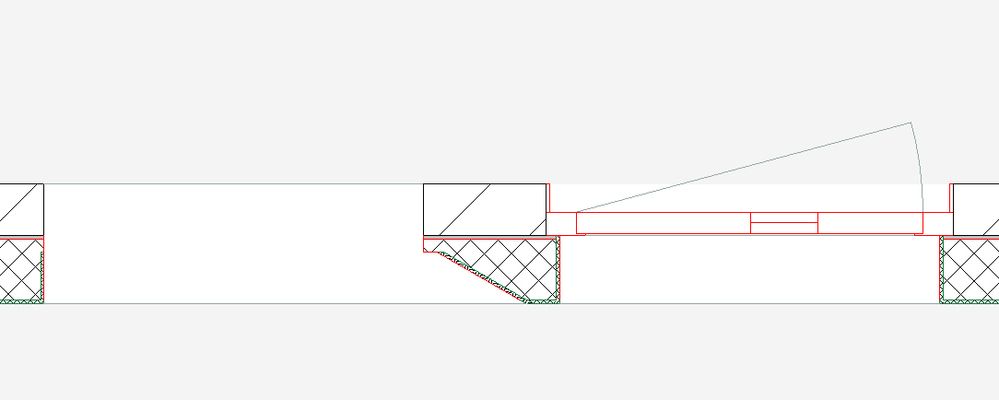

Hello,
I want to realize a jamp on the external surface of my wall (see pic). The idea is to carve the insulation layer.
Is there anyone that know how I can realize this?
One of the solution that I found was to separate the elements around the window, but this is too complicated. I obtained too much elements and there is too much different jamps of my facade
thx[/img]

Easy,
Pick any door you want to use,
Go to the Reveal option
Pick Slanted Reveal and the add the angle you want to add on section and plan.
There you go!

Thx I saw that option.
However this is only for reveal on the internal part of the wall, isn't it?

You can also put an empty window on top of it (two windows) and use that to make the slant.
That way the actual window behaves properly with inside and outside facing option like 'vensterbank', 'onderdorpel' etc Too lazy to find the English words.

Okay thank you, I think that I'm almost at the desired result...
On the picture you can see what I obtain (A)
And B (photoshopped) what I really want. insulation has to go over the frame.
Do you guys have any ideas ?

Pretty tricky to get that exact with just the parametric settings from the windows. You can get close, I'd say close enough for 1:100 / 1:50 drawings, as no-one will actually see that plaster detailing at that scale when printed.
See screenshot below.
If you want to get the plaster exact and right you could punch a hole that is bigger than the window with an emtpy opening and model the side with 2 complex profile collumns. That way you'll have the 3D model correct too.
Are you sure you want the insulation in front of the window though? Seems like an odd detail.

It is essential yes, we are an office specialized in passive architecture. limit the thermal bridges is one of our crusade 😛
Mats_Knutsson
I would use a morph to cut hole the instead of the extra sized hole w columns. I don't know the implications though./M
