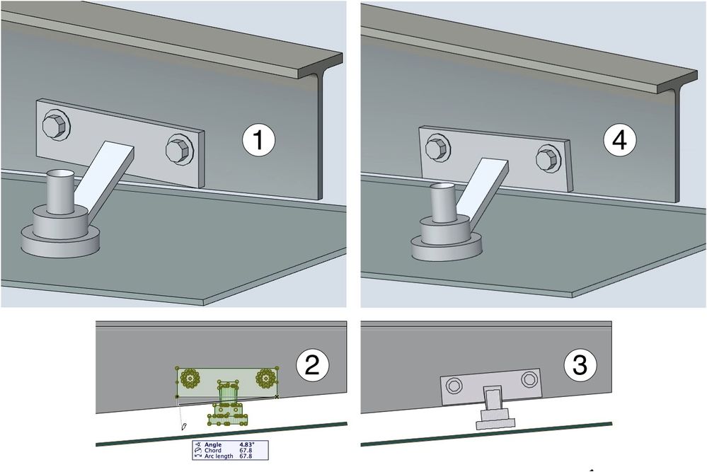

This is easy to do with OBJECTiVE. It will both upgrade your objects with rotation properties and give you the tools to do it. Referring to the attached image:
  • 1. The 3D view before rotation.
    2. Open a section view, select the object(s) to rotate (you can rotate one or many objects about a common axis), click the menu OBJECTiVE > Tools > Rotate, and rotate just as you would in the Floor Plan (define start and sweep angles).
    3. The finished rotation in section
    4. And in 3D.

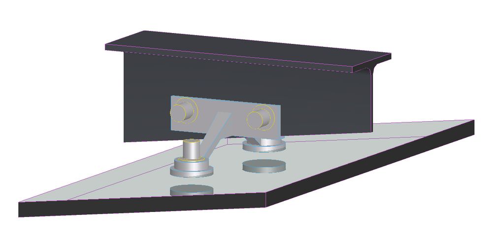

Your link has been very useful and now the library part rotate beautifully. Will attach a picture of the final result FYI
