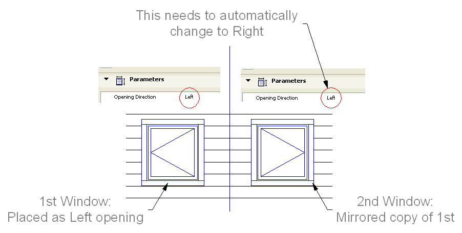

Hi All,
I've scripted a simple, office standard casement window. It works perfectly except for one thing. The user has the option to choose: Left, Right of Fixed as the opening direction. The problem is that if the window is mirrored it still shows the original opening direction parameter even though the opening line is correct. The script below shows an attempt to fix this but it doesn't work. Any thoughts?

Thanks for your replies. I've posted a picture of this issue to simplify things (should have posted it originaly but didn't have time). Peter, your script is pretty much what I started with. The problem is that when the window is mirrored the opening dirction parameter still reads Left (see below). I'd like it to change atomatically.
Doug
Hello Doug,
I don't know whether the PARAMETERS command works on
value lists but if you put your lines that contain the PARAMETERS
command into the master script we will both find out.
Please let us know how it works out.
Peter Devlin

At the last line of the code you always had the OP_DIR to "Left" therefore it is static (in your 1st example).
It might work arranging the code like;
!--Master or value script
IF OP_DIR="Fixed" THEN END
IF SYMB_MIRRORED THEN
	OP_DIR = "Right"
ELSE
	OP_DIR = "Left"
ENDIF
PARAMETERS OP_DIR = OP_DIR
!--3D script
IF OP_DIR="Left" THEN
	ADDX A-7.5"
	MULX -1
ENDIF
ADDZ .25"
LIN_ 0, 0, 0, A-7.5", (B-7.5")/2, 0
LIN_ A-7.5", (B-7.5")/2, 0, 0, B-7.5", 0
DEL (OP_DIR="Left")*2 + 1
Hope this helps and works.

Hi Juha,
Thanks for ypur code. I don't know if I'm missing something but I've tried it along with several variations but can't get exactly what I'm after. I'd like to be able to place a window, Left or Right and mirror either one and have the op_dir parameter change accordingly. I've attatched a zip of the part so if you guys have a minute you can look at it. I tried to find a similar parameter in the AC11 casement windows but couldn't. My thought is that more that likely it will be scheduled using the ID so the user will have to change the opening direction in the ID manually anyway (or place the window using favorites). Either way I might be wasteing your time with this issue. I'll keep digging.
Thanks again,
Doug
