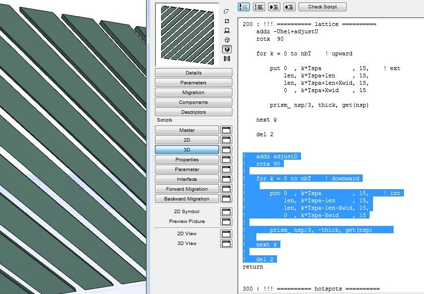

vistasp
A teeny weeny bit of GDL will very easily do the trick.
Edited: You beat me to it but it might help someone else. Just comment out the highlighted part.

Srinivas
yep did the same, just added an operator with an if statement, so that I can turn on/off the double lattice. thanks again.
