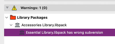

Library pack has wrong subversion?
what does this even mean? these .libpacks seem to have only simplified archicad for one group of people... and its not us at the end user side.

Patrick M
I'm going to need someone to explain to me how to fix this... like explain it step by step... and if it involves any back door rewriting of the libraries or checking compatibility of .libpacks, I'm going to need someone at graphisoft to resolve this at a software level... this just can't be a better option than version specific libraries.
I've yet to see anything better or easier for the end user with these .libpacks...

Just a wild guess about where to start:
There are commands for extracting and creating lib packs.
So, you could extract the lib pack, and check the extracted files. There is a file called "package.info". If you open it, it is an XML file, and it has some "subversion" data in it. You could try to change it to a number that a working lib pack has. Then recreate the lib pack and see if that solves the issue.
Otherwise, if it does not, you may have to reinstall Archicad.

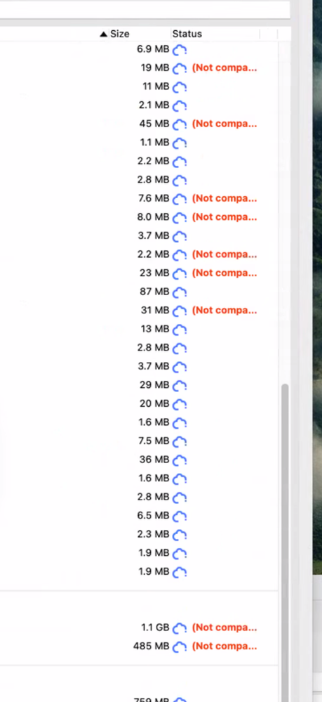

Patrick M
Laszlo, this is exactly what I meant. the step by step is just not a feasible or reasonable solution for 99% of the people I work with, and not a solution I want to take ownership of.
If I understand you, I have to extract a .libpack, that is 100% out of the box installed from the downloaded .dmg install files, it has been updated in my applications via the library updates, and updated on the bimcloud (which is a painstaking process now that we have 37 different libraries to check for up-to-date-ness), and I still need to extract the libraries to verify that graphisoft has not released some .xml data that is not compatible, and EDIT the .xml data; not only do I feel like I'm outside my wheel house, but I feel like I'm doing graphisoft's job for them.
furthermore, I fail to understand why I would need to reinstall archicad; these computers aren't reading the .libpacks from the application folders, they are sync'ing local to server data. If the .libpack is up to date on the bimcloud, how could it possibly be incompatible?
I'll admit, I'm not always the sharpest tool in the shed; but from what you are describing here, this falls in to the "not my job" category. Definitely not in the role of an average architect, drafter, or designer's role in a firm.
coincidentally, as I read your response, I was on a zoom call with another architect who saw about 10-15 libraries in their library manager reporting "not compatible"

Patrick M
I still don't understand how this could happen on BIMcloud though. If I update my libraries on this computer, then run the library update for all 4 dozen (+/-) .libpacks on each bimcloud, the server's libraries are updated. Everyone in the projects should get updated local data when the join the file or send receive. How could their local data by outdated, if the local data is based on the server data?
do we really need to coordinate everyone to leave every project and clear all local data with every library update? I understand most people aren't working with 150+ people on a weekly basis; but I'll have to hire a nearly full time library maintenance manager if this is REALLY the way it works.
