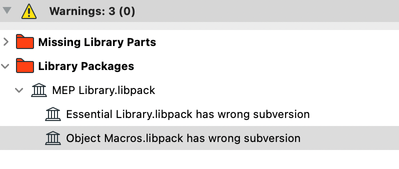

Library pack has wrong subversion?
what does this even mean? these .libpacks seem to have only simplified archicad for one group of people... and its not us at the end user side.
9 Replies 9
runxel
Well, only the "normal" object library is backwards and forwards compatible – the MEP library on the other side is always tied to the version, and will probably stay like that for a while.
So my guess is there is a version mismatch here between AC and the library.

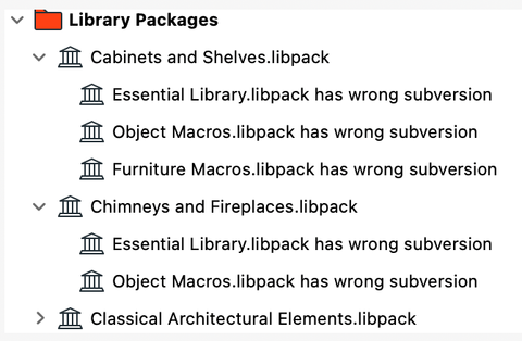

furtonb
Same error, I've never seen this before.
This file was just uploaded from a .pln to a BIMcloud:
The problematic .libpack files are on the BIMcloud, the file was started in AC29.
How to resolve this?

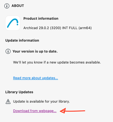

I think I found it: make sure to update your libraries too...

Yeah, the libpack updates are not backwards compatible. So if one person updates theirs, everyone needs to update.

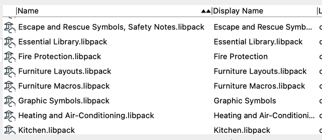

I'm like 90% certain the whole reason to switch from .lcf to .libpack was less work on the software developers side... on the user side, it takes a software developers understanding of the tool to get a file's libraries sorted out any more.
I mean, take 1 library + a migration library and turn it into 40 separate libraries that all still need to speak to each other in some capacity (macros, etc.), and need to be coordinated for updates individually... yeah, this wasn't for the benefit of anyone on the user end of things.

Yeah, I do not get why AC cannot just read a folder of Libpacks. Sure, libpacks give the user more flexibility, but most do not need it... Just give the user a folder of their localised libraries that they can add to if they need to.
eg. I just load "Library (AUS)" folder and I get all of the generic and AUS library parts. If I want the "Japanese Arhcitecture" library, I just copy it from "Other Libraries"  folder into "Library (AUS) folder.
