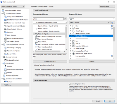

3.you place all library parts
(3.a. add the command to your work environment so you can use the command)
Options -> Work Environment -> Menus
search for "place" in "All commands in alphabetical order"
click on the menu on the right column where you want the command to appear
(or they are just greyed out in the left column)
drag the "Place all objects" command to the location in the list where you want it to appear
then you can use it...

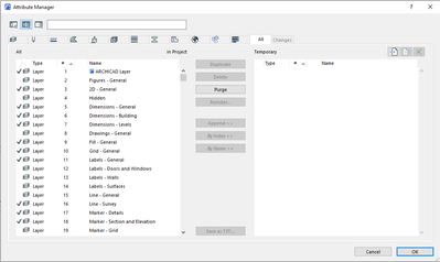

4. you purge the unused attributes.
4.a. all tab, purge
5. you have your list
4.a. all tab, purge

AllanP explains how to find attributes used in library parts.
But don't forget you also have those used in composites and complex profiles.
You will need to place a sample of each of those as well, and have a look at your Attribute Manager again.
