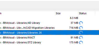

I have opened up a teamwork file and there's a lot of missing library parts. I previously haven't had any issues with this file. My colleague has also been able to work in the file and the library parts don't appear missing for her.
I tried reloading libraries but can't think of what else I can do. Any ideas?

Your Library Manager should tell you where those missing objects are from.
You would then need to load that library.
I have reloaded the library but no file size appears next to it. The files seem to work for my colleagues.. could it be a my computer issue?
AC26 | Win11 | 64 bit | 32Gb RAM | Intel i9-9900K @ 3.60GHz
I don't use BIMCloud, so I am not sure.
Aren't you supposed to sync the BIMCloud library with your machine? - I could be wrong about that.
All the other libraries are syncing fine with the BIMcloud. I suspect it's something to do with my computer.. just dont know what it is.
Solution
Confirming it was an individual machine issue - fixed it by preference cleaning https://community.graphisoft.com/t5/Installation-update/Preferences-Cleaning/ta-p/303676
