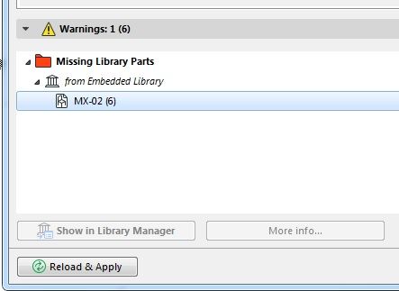

I have a missing library part that is driving me nuts. I've searched far and wide for it and gone through all the various Find methods recommended in the Help guide to no avail.
Is there a way to force ARCHICAD to remove a warning? Or is there a way to "purge" unused Embedded objects in the model?

If it's in the model, it's not "unused." Is this a 3D object or a 2D object? (2D can be lurking in a section/elevation, or detail)
You might try creating a schedule for this object, which could tell you which layer/floor/etc. it is hiding on.

It's a 3D object.
I've had a look at the Object and the "missing" library part is not there.
It could also be a missing macro that the object is calling.

Any tips on how I would find that missing macro?
It might be good to end the suspense and include a screen capture of the error message.

See attached, many thanks.
What happens when you highlight the object and click on "More Info"?
Richard
AC26 (since AC6.0), Win10
No can do. It is greyed out even when offending object is selected.
