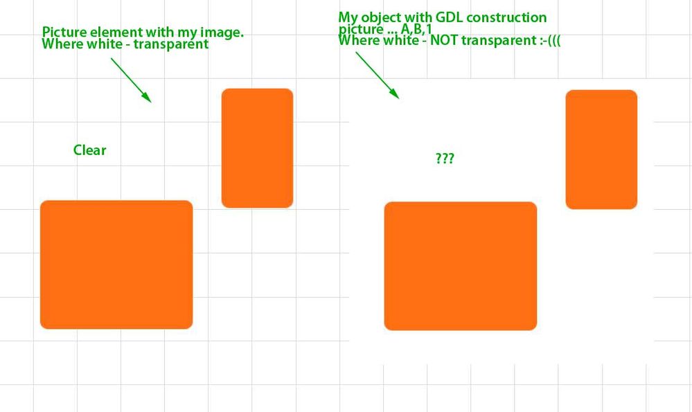

Hello!
I was create image with any paint and absolutly white fields.
In element "picture" with option "transparent" white fields are transparent (as I need).
But in GDL on object, this image not transparent. This code:
picture2 A,B,1
1 - is mask, that mean show transparent.
Can I show it in my object with clear white fields?
Help me please...
Thank you.
2 Replies 2
Hello,
Try PICTURE2{2} a, b, mask
For PICTURE2{2} mask = 1 means that exact white colored pixels are transparent.
Its work... !))
Thank you very much, Juha!
