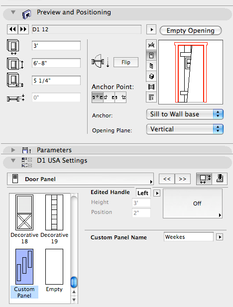

Hi Peter:
Any idea why my custom door when placed only partially shows? It's sliced by a diagonal line.
(It's been a long time since I've created a custom door)
Marc Corney, Architect
Red Canoe Architecture, P. A.
Hello Marc,
That is indeed strange. Do you recognize what appears to be
another type of door panel on the other side of the diagonal line.
I am assuming that you modeled a complete door, frame, and trim
in the floor plan and saved as a door because you seem to have
prairie style trim and a cleated door panel. It's as if you have
a custom door panel enabled as well as your modeled panel.
I have never seen this before. I do not do many auto scripted doors
or custom door panels
Peter Devlin.

Thanks for the reply Peter.
The lines to the right of the diagonal are a window on a wall in the background. Actually, I only modeled a door panel, which I then
placed as a custom panel in a D1 12 DOOR.
I may just do a 2D patch as I'm a bit pressed for time.
BTW, Looks wrong in the preview too.
Hello Marc,
Have you tried to open your custom door panel via file->Libraries and objects
->open object and navigate to the folder that contains your custom door
panel and select and open it to see in the GDL editing environment's
3D view if the panel is cut in the same way as you see in the preview
and the elevation ?
Peter Devlin
Stress Co_
Ahh, thanks Peter.
Looking at the 3D editing enviro. made me realize I created the door in plan with a rotated grid. All is now as it should be.
Djordje
Moderator Emeritus
It is also essential that the project origin 0,0,0 is at the middle of the bottom of the door.
Same for all the objects that you create from the plan. ALWAYS model them so that the default insertion point is at 0,0,0
