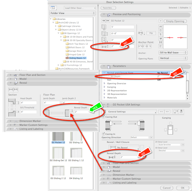

I was able to transfer parameters to a pocket sliding door (AC12) and get the panel to center in the wall.
The strange thing is ... the "Sill/Reveal Depth" is grayed out (i.e. locked) in three locations in the Door Selection Settings. You have to open the "Reveal" detail to adjust the depth.
BTW.... The Sill Depth settings were "locked" prior to transferring parameters.

A start from scratch door doesn't work for me.
The settings are locked...... everywhere except the "Reveal" sub panel.

I just encountered this problem in our office with a collegue of mine.
It seems that you need to go to the Reveal page of the Door Settings panel of the Dialog.
There are so many Reveal types now that probably the developers found it better to disable these settings as with many of the Reveal types they do not apply.
This is with INT Window/Doors.
